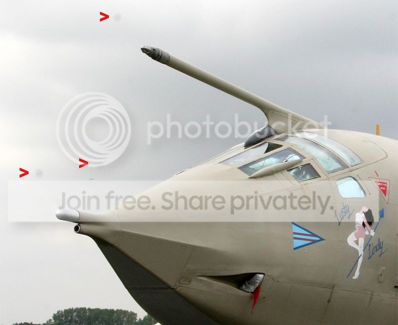

+1 for sensor dust, does it look like this?

You can either knock it out in photoshop, use the dust mapping function in camera if yours has it or do a full sensor clean with sensor cleaning swabs. It's relatively easy to do but if you pull any of the oil across from the shutter mech or scratch the sensor you'll end up with a paperweight. You can take it in to most decent camera places who will do it for you for about £40.
