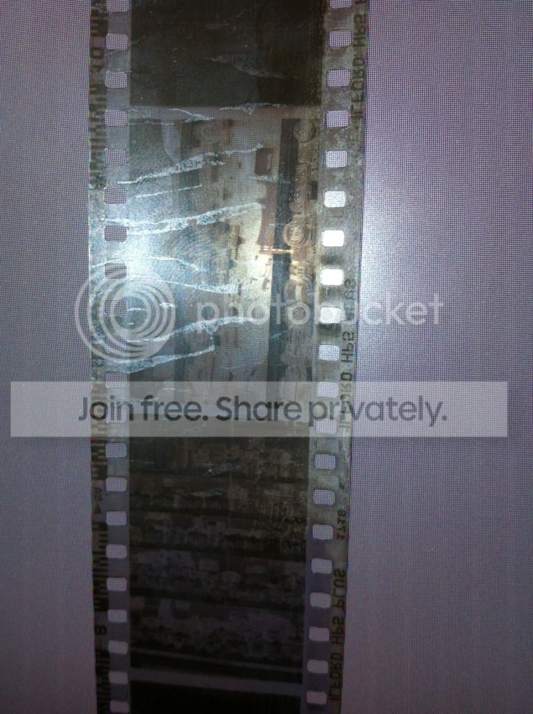

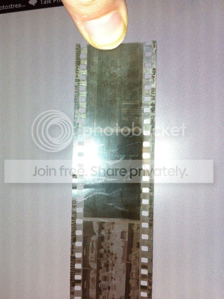

A rather odd problem here, one roll of my black and white negatives have started to go brown in an odd pattern, I wouldn't be that bothered about it but it was my first roll of film and holds some sentimental value (even though its in fairly rough shape) BTW the film was HP5+ Devved in DD-X over a year ago
I tried cleaning them with Isopropyl Alcohol and it made no difference as the staining appears to be inside the emulsion. As a bit of a hail Mary I'm going to give them a wash in some fixer and see if that does anything.

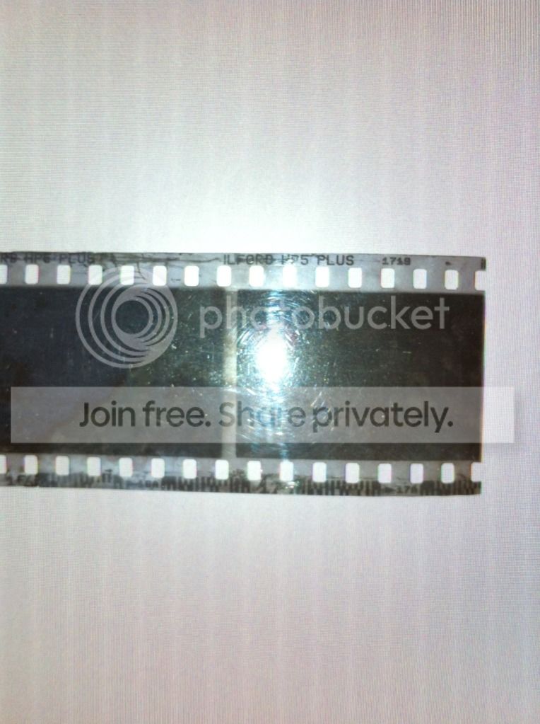

The patterns on the third photo are due to the neg sleeve getting crinkled
Has anyone experienced this or know of a solution?
Here are some photos of what i'm rambling on about
