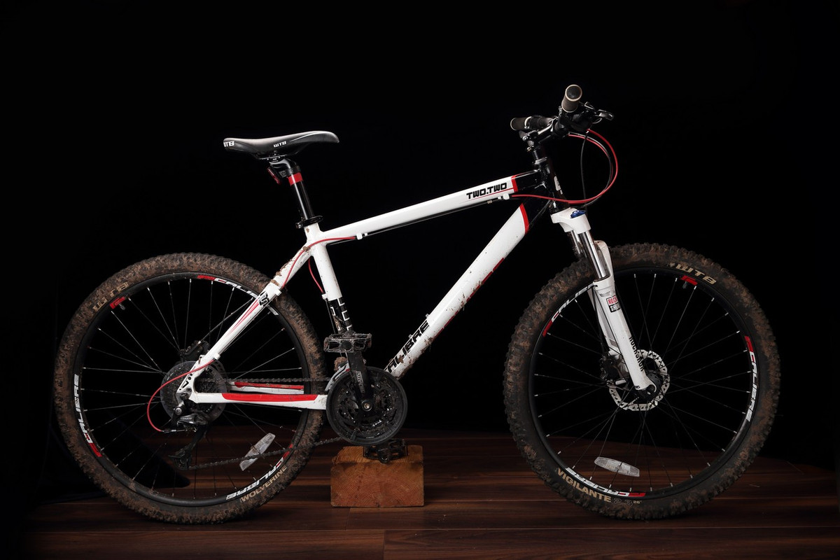

Hi all.
Some time ago my Daughter asked would I mind picking this bike up from her Uni accommodation. Obviously being a Dad it's the type of thing we love to do ;-)
This bike has been lurking around our shed for yonks plus said Daughter is skint and so suggested we try and sell it on you know where.
I took a few snaps on my phone as is the norm these would be fine I'm sure.
That said it occurred to me I could have a go at lighting it. I was time rich earlier today. This is the outcome of my efforts. I'm no expert by any means but enjoyed the challenge.
Off the reading I have done in the past it seems lighting from the top is a starting point so that's what I did. Then add the softbox to the left hand side and eventually the bounced speedlight to the right.
I was unsure how much I should be lighting really. That said whilst typing this out it feels obvious that everything needs to be lite ?
It would be great to get some feedback as to how I should have gone about it and how I could have improved the results.
Softbox at back as AD200
Softbox left 580ex
Bounced right side 580ex

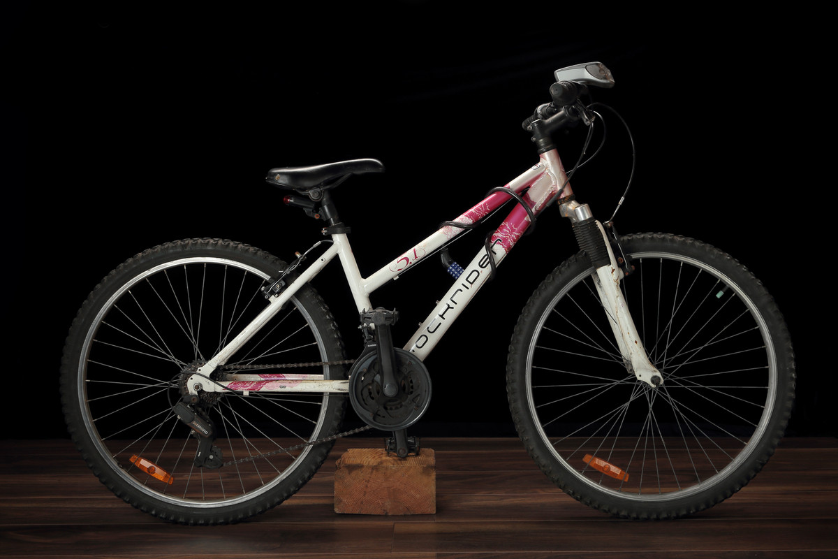

2
It's a nice first attempt IMO.
There's a few things I think could use adjusting. The light on the left is feathered a bit too much which is causing a heavier vignette on the left side and dropping the left wheel a bit too dark. Secondly, the lights from the left and right are causing incongruent cross-lighting highlights and shadows (i.e. catchlights on rims).
TBH, your lights are a bit small for this subject. What I *think* I would do is combine the two softboxes overhead for a larger single effect; flatten them out a bit (angle) and move them closer (reduce power). You probably also need to angle them a bit to follow the overall angle/height of the bike (i.e. match the slope of the cross bar).
I would then use the large reflector from the front as bounce fill (probably use additional panels if avail). The remaining speedlight might be used for additional fill or to highlight something left out... if used at all it would likely be hard and at a very shallow angle from one side.
@sk66 Thanks that's really great information and the bonus is I actually understand most of what you have written. Often times the penny does not drop and I just don't get what people are trying to tell me. Yes the darker left hand side bothered me too. In my first few frames I didn't have the light feathered so much but I was getting a blown highlight on the front chrome mudguard. That said I still do but much less & yes I agree it did leave the rear tyre darker than I would have liked. Another reason I feathered the softbox that much was to try and spread the light right across the bike and then not need the bounced speedlight. I was most probably wrong in thinking that way ?
Not sure on the cross lighting thing. Do you mean on the right hand wheel the highlight should have been on the far right of the rim to look correct as though one light had been used ?
Things like the angle and placement of the lights makes sense to me, now you have explained. These are the things that make all the difference but a hard to learn.
Thanks
Gaz
Raking one light across the bike at a shallow angle is not "wrong," it is useful in bringing out smaller details that flatter/diffused lighting hides. But there is no need for it to be so large/diffused... smaller/harder lighting placed at a greater distance is actually more beneficial for that. If you were to look back at that softbox from the perspective of the bike you will see that what you have done is create a smaller/harder strip box effect. And it's too far away from the rt side of the bike to be soft/diffused at that point, which is why it was causing blown highlight issues.
Yes, essentially that... Basically you generally want one key light (the overhead in this case, but it could be a different one) as the primary light providing the overall feel/direction. The other lights then add to it, but should not overwhelm the scene. In this example you essentially have 3 lights from 3 directions, all with relatively equal emphasis/impact.
Also note that with a "product" as large as this, and with the equipment/space shown, it might be easier to use just one softbox and the reflector to light smaller sections/areas at a time and then combine them in post (keeping in mind the overall direction/feel).

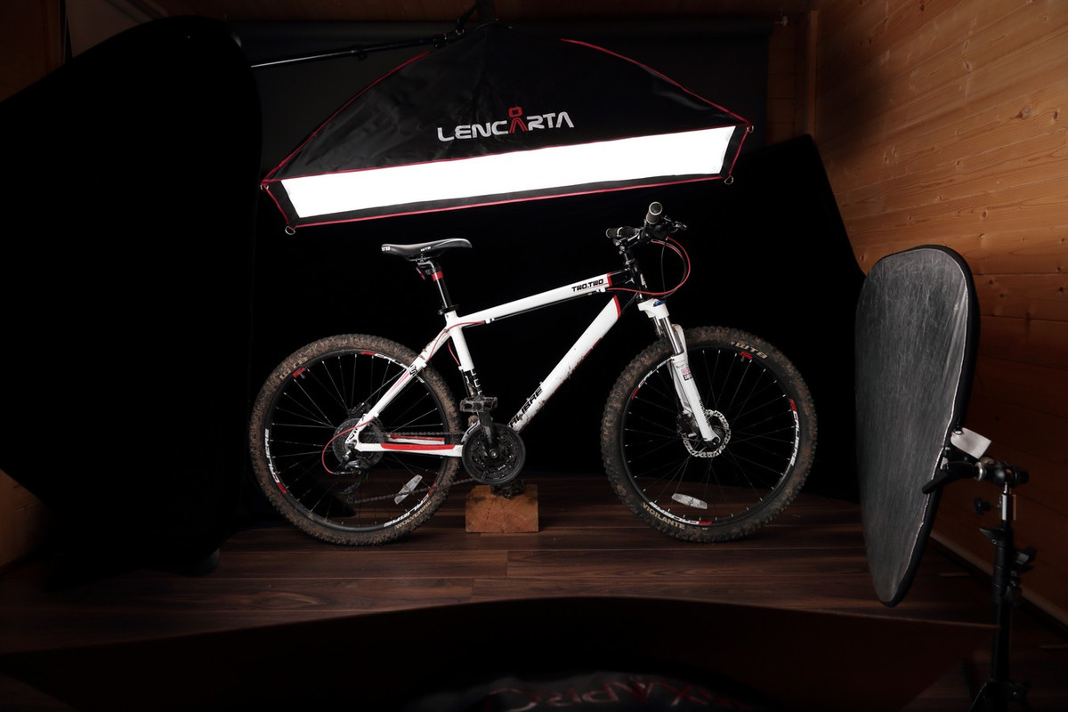

Hi everyone.
After the post above I have since purchased the 140x27cm stripbox from the advice given above it arrived yesterday. I realize that an even bigger one may have been better but for general use and the space/lights I have I thought this was a practical choice.
Eager to play I tried the box out last night. Going off the advice above and the video linked too I started with the stripbox above.
The light did stretch across the bike further as expected. Again going off advice above I decided not to use the speedlight bounced on camera right to omit the conflicting highlights.
That said I could not find a way of just using the srtipbox above and reflectors from the front due to my shooting position unless I'm just not understanding the advice given.
So I used a larger softbox to camera left 80x80cm largest I have. Not feathered anywhere near as much as last time. I'm still struggling to get light right across the length of the bike without having the near wheel and trim to bright even when feathering more. Is that the wrong approach?
I am thinking I could just use a fill light from above behind camera but my gut is telling me that would be flat lighting and sending the light everywhere ?
The image below is Stripbox above angled to follow the bar and flattened out more.
Softbox camera left moved many times to get light as far across as possible without blowing highlights on right rim.
Reflector camera right just out of frame to bounced light back onto far wheel.
Also hung some black fabric up for background.
I seem to be able to light things to get me going and a reasonable result but when it comes down to fine tuning I am struggling to see the changes in light and what effect they are having.
Would appreciate any input at all.
The Bike as had no editing done to it.
Gaz
Well, that's a massive improvement isn't it?
Lighting with the right approach always has this effect, it's relatively easy to achieve this level of improvement but very much harder to get the extra 10% or so that produces perfection, it's the law of diminishing returns:)
You bought the right strip softbox. When I was with Lencarta I got the larger, 2m one made, it's a good product and especially for fashion photography in large studios, but it's pretty massive and very awkward to use in a confined space. Just for a start, it's much deeper, so needs a lot more ceiling height, then there's the problem of getting it up there and holding it in place safely.. I see that Lencarta no longer sell their heavy duty boom arm, I've looked at a couple on a competitors site and I wouldn't trust those models to hold a feather in place, let alone a 2m softbox, so you made the right choice.
An 80 x 80cm softbox is far too small to produce the diffused specular highlights that would be nice to have on the brightwork, 150cm would be much better but again would take up a lot of space in a home studio. A silk, something like a large shower curtain, and lit by a softbox, would be even better but again space is very likely to be an issue.
The Inverse Square Law has worked against you here, producing (inevitably) far more light on the saddle and other high items than further down. The quick and easy way of dealing with this is in PP, a simple job. The "lighting" way of doing it is to stick bits of neutral density gel onto the front softbox diffuser in the right places. I've always used masking tape for this, it comes off cleanly and has just about enough stickiness to hold the gel in place.
Nice progress IMO.
To get the result you want from reflectors can be very intrusive. There have been many times where I had to use the camera tethered and a remote release simply because there wasn't enough room for me... but it's a good practice anyway. If it's inefficient you might need to use silver rather than white... the results will/should be subtle but worthwhile in getting that last 10% (you may well need to bounce the spill of the feathered crossing light rather than the overhead).
The problem with your crossing light is that your space is too small. In order to get even light across the bike the light needs to be far enough away so that the length of the bike is not a significant difference in distance from the light source (ISL). I.e. if the bike is ~4ft long then the light would need to be 16-20ft away for ≤ 1/4 stop difference in power at both ends.
In your situation a more practical approach would probably be to use two lights from the same position at different power levels (and feathered appropriately).

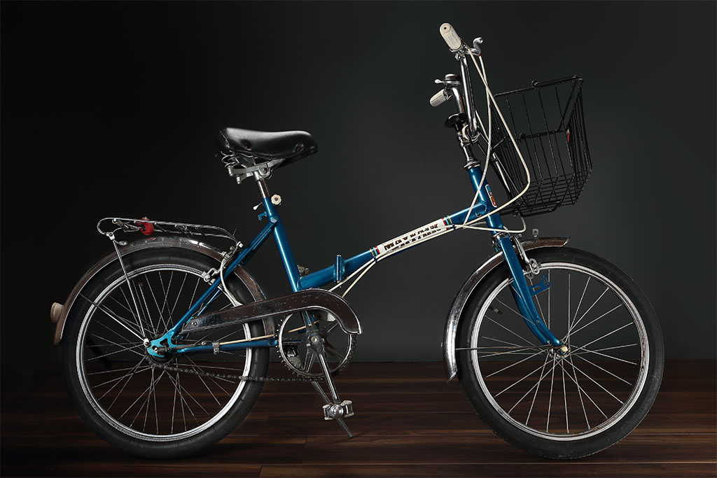

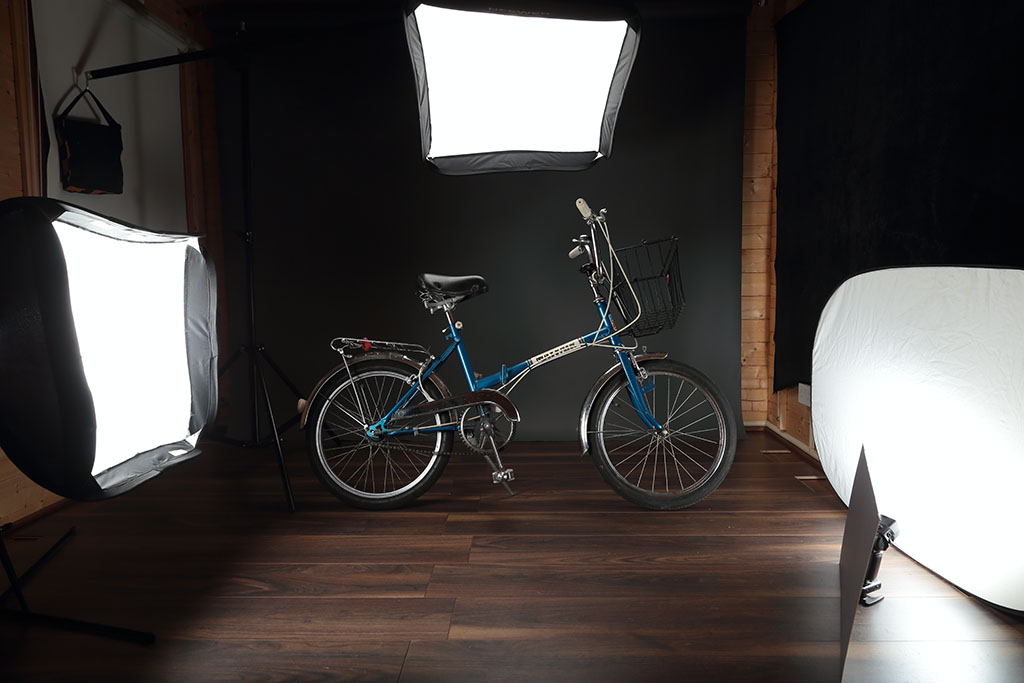

Had another little play before I tidied up. It seems every product reacts differently to light. It's a great skill you people have learned to be able to look at an object and instinctively know what type of lighting will work to bring out the best in your chosen subject.

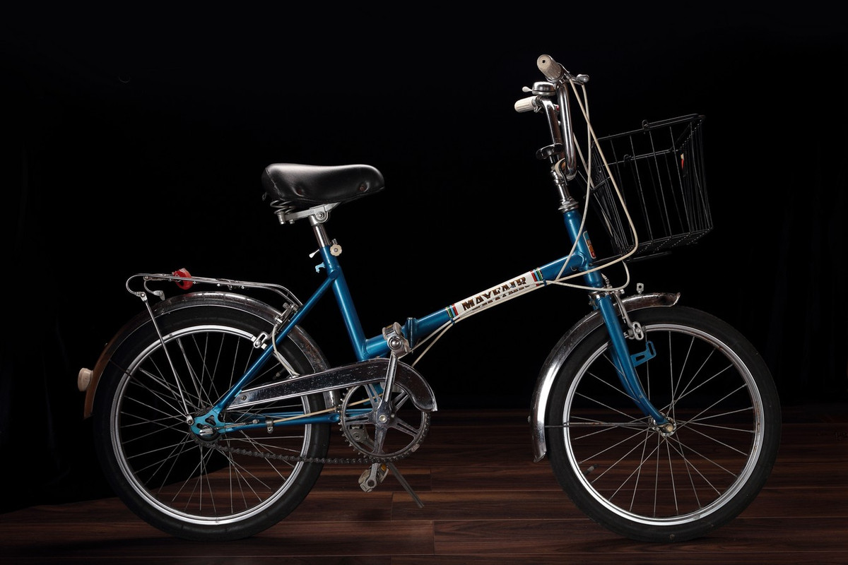

Just to bore you all a bit more with this.
It dawned on me last night before I took the lights down that maybe I could have placed the boom stand outside as there is a window right behind it's position in the photos.
So I gave it a try. Stand was at its limits and I had to add extra weight to hold it firm.
What it did though was to get the legs out of the frame,made so much differance as the image looked much cleaner straight out of the camera.
Managed to get a white card closer at the front too.
Did lighten the trye to camera right a tad and the pedal cog. Using @sk66 soft blend layer tecnique. I would normally have used a 50%grey soft light layer, painting with white of black as required.
Gaz

Getting that stand out of frame is a big plus!
It was ! I was very pleased with the outcome of the last photo.

strip softbox in its latest position
I agree I did think that the light position in the last photo was much better. I had it placed a bit higher flatter and more aboven & forward than previously.
I should work well, just try it. Get a reasonable amount of distance (6'?) between light and subject, to minimise the inevitable fall-off caused by the ISL.
I have cleared everything away now but I will give it a go. I think those area's really did need a lift as on the full size images I thought they were really flat the details should have been popping out.The teeny bit of light (due to floor reflector) I got on the pedal cog in the last photo proved that to me.

On another note.
When taking these I set all lights to not blow any highlights. Apart from that problem I had with the very first image ( chrome mudguard )
Is that always the way ? For example in the white framed bike. Along the crossbar could that have been left to blow a touch to give the dimension (specular highlight) ?
There is dimension to it but I was thinking it maybe would have looked more 3d if there were a brighter specular hilight.
I am unsure as to whether it is the done thing (anytime) to allow the highlights to blow.
Gaz
I don't normally want things to clip to pure white unless it's a specular reflection on metal. Increasing the light/exposure on the crossbar (2nd bike w/ white frame) would not have caused more of a specular highlight/reflection... it would have increased the exposure more equally/entirely... to get a specular highlight and not increase the exposure would require 1. the light to be much closer (ISL), or 2. a light source farther behind (reflection along top edge, source not hitting front side).
Sometimes what you need to do is provide negative lighting (black panels) in order to increase the contrast in those areas.
[/ATTACH] superfast_300_threequarter_left_front_white.jpg
On another note.
Gaz
There aren't any rules about this.
Sometimes we want to create more psazz at the cost of detail, sometimes we want it to show more detail at the cost of psazz - whatever suits your purpose.
A specular highlight is just an (inevitable) reflection of a light source. A diffused specular highlight is one where the the specular highlight has been enlarged so that it is occupies a larger area, doesn't have hard edges and is translucent, so that we can see through it to the subject beneath. This is achieved simply by relative size, i.e. a big light source as close as possible to the subject.
For example, "ordinary" specular highlight,a standard reflector a couple of feet away
Diffused specular highlight, large softbox very close
Another diffused specular highlight, this time with a separate softbox for both top and bottom of the flash head, and more challenging to light
