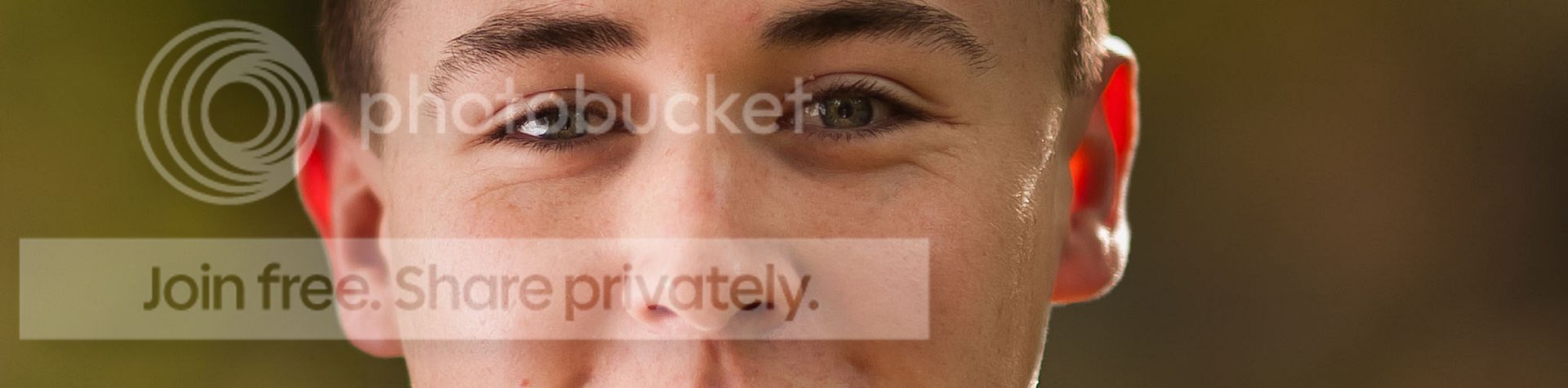

Hi All.
I was in a forest on Sunday, and I grabbed a quick shot, unplanned of a friend who was backlit quite strongly.
As you can see, his ears are backlit, and appear quite furry.
He likes the shot, but wants me to get rid of the fuzzy bits on his ears.
Suggestions on how best to do it please?

And the offending ears :
[url=https://flic.kr/p/AnuHkc]Furry ears (2 of 2) by Gary Hickling, on Flickr[/URL]
The shot was awful SOOC, as the woods were dark, dappled sunlight bright, etc, etc.
I've already done some editing, but not sure best way to do this bit.

Gary zoom in on the ears, I think its more a case of burnout than back-light and its the actual ear that's been lost. the back-lit hairs are negligible.
A simple clone with a soft edge brush.

Pen tool to protect/redefine the shape of the ear (the edit above looks dodgy on camera right because it's taken a chunk of ear off). Clone out the hairs using the soft background. Invert selection and rebuild ears using clone and/or paintbrush.

The pen tool takes some learning...especially how to make complex curves that reverse directions. But, it's a pretty essential tool for advanced editing IMO; definitely worth learning.
BTW, I made the selection area extra large so I could mask/feather it into the BG better.
Just to add I'd echo using the pen tool for initial selection but once selection is made a good way to get a cleaner edge than cloning when you have a plain or blurry background like this is to duplicate the selection so you have the person isolated and then use liquify or warp on the underlying layer to push in the edges slightly which keeps it looking more organic.
on the below image...
  1. Duplicate the image
  2. create a selection with the pen tool isolating the head
  3. right click on the path and select to convert path to selection
  4. for this image size feathered edge 3 pixels
  5. with the selection active press ctrl+j to duplicate selection to new layer.
  6. click on the background and use the liquify tool to push in the edge past the selection, it' takes a wee bit of guess work as you only see the background layer in liquify but it's fairly easy to work out, just don't be too heavy handed and sometimes best to use a few passes.
  7. mask out any unwanted areas from the middle liquify layer
result...
Another tip which you may or may not want to use which I picked up from a video I can't remember is if you know a subjects being strongly back lit a bit of black gaff tape on the back of the ears stops them glowing red. Not an every day use but if you're doing headshots like this it does make a difference.

What happened to his earlobe?
You do make a good point... the liquify tool is good for "taming" hairs but leaving more "context." I did this in less than a minute with just liquify, no masks/selection/layers/etc.
You do make a good point... the liquify tool is a good tool for "taming" hairs but leaving more "context." I did this in less than a minute with just liquify, no masks/selection/layers/etc.
yeah just reedited post to do proper selection, rushed with the liquify and pushed down where I shoulda pushed up, should be right now, pearls of rushing :D
