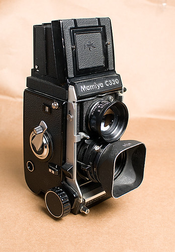

The Mamiya

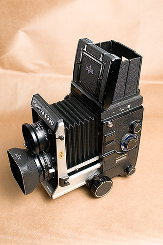

the bellows 'appear' to be in excellent condition, but need to find out for sure aswell as any body sealing

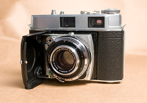

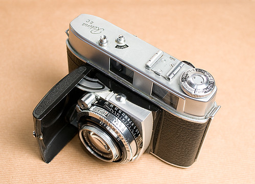

..and the Kodak Retina IIC rangefinder, which without film, seems to have a functioning shutter and film wind on mechanism.

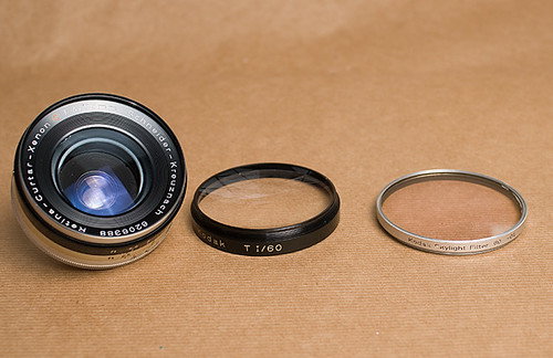

the 35mm additional lens plus 2 filters, a skylight and ?? It seems to magnify things when you look through it but not yet attempted to attach lens to camera and check what effect it has.

I wouldn't worry too much about the bellows on the C330. The most likely cause of problems is cracks in the folds, and they tend to be obvious even on a quick inspection. While it's possible to get pinhole leaks in the bellows it's more unlikely and usually due to neglect and unsuitable storage conditions.
I don't think you have any seals to worry about other than the ones that seal the film door ? Have a look at them. With time they tend to either go very dry and brittle with bits flaking off, or degenerate to a stiicky, tarry mess - again with bits coming away. If they're OK pressing them with your finger nail will see them spring back to retain their shape, but I'd guess they're almost certain to need replacing given the age of the camera and the fact it's been stored.
No worries at all though - an absolute doddle to do with one of the 'Interslice' kits off ebay. It's a geezer called Jon Goodman and he couldn't be more helpful.
If the bellows look fine from the outside then I don't think you will have any problems.
These cameras actually have two sets of bellows. The rectangular set which covers the whole of the lens board area and another square set which fits inside and just covers the main taking lens.
Even if there was a pin hole in one set, it would be covered by the other so should not be a problem.

The shutter problem that the Retinett's suffered from was small amounts of oil from the shutter mechanism leaching onto the blades. This oil caused the blades to stick and wouldn't open. ( Yes i know oil is a lubricant, but as a thin film it can cause problems).
It's not a difficult job to get at the blades and clean them, but it is a job for a specialist.
If the shutters are working OK, I'd say leave alone and enjoy the cameras.
The other filter looks like a +1 diopter close up lens.
