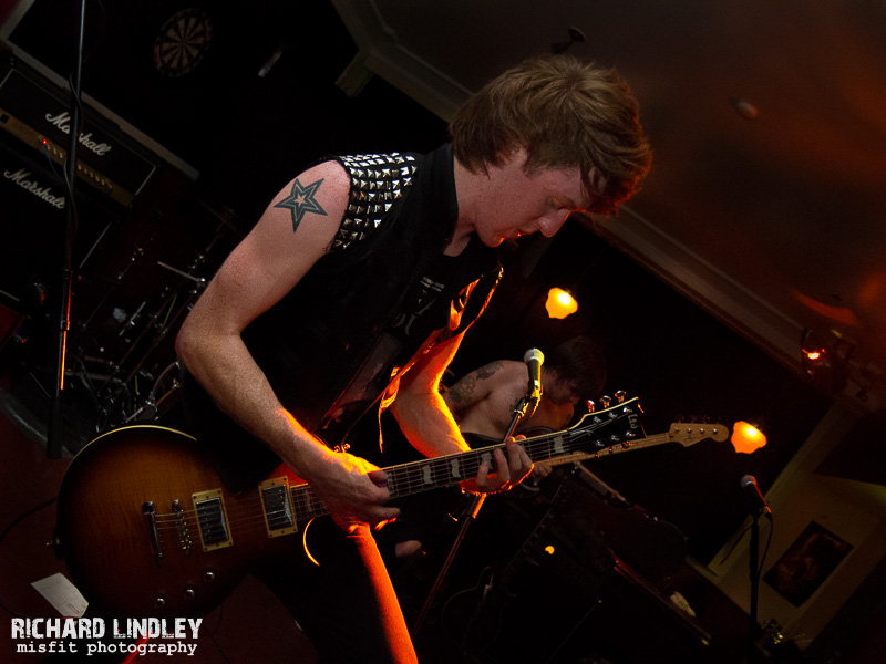

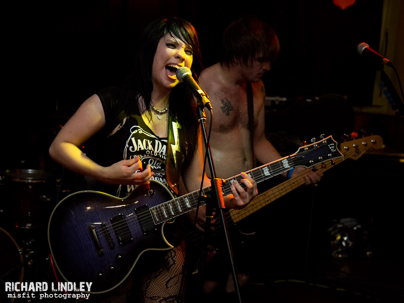

I also disagree that shots using flash are bland, not if you use flash well. I shot the below shots with flash... ISO6400 F2.8 1/60th and flash set to about -1 to -1 & bounced off the ceiling (Which, lucky for me, was white). The pub lighting was aforementioned disco lighting.
Skarlet Riot by Richard Lindley, on Flickr

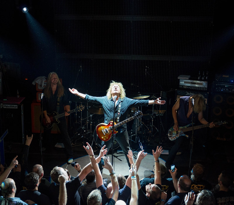

And depending on where you are in the crowd, flash might not be much use.
Y&T by Cagey75, on Flickr
That was taken from the VIP balcony, flash wasn't doing me any good from there.

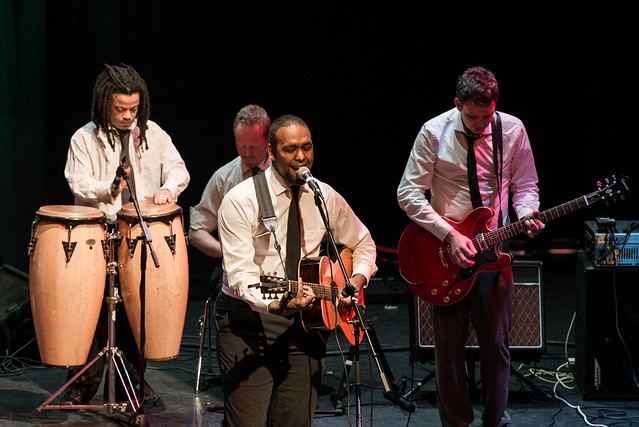

I shot a gig featuring 12 musicians in a large venue Friday night. I was given freedom to move about, but flash never came into it, though I had 2 units with me.
The lighting was good enough that I got some shots at f/4 - f/5 without having to bump the ISO too much. It really depends on the lighting.
Brother Shabo & the soul rebels by Cagey75, on Flickr
Lens: 70.0-200.0 mm f/2.8
Exposure: 0.01 sec (1/100)
Aperture: f/5.0
ISO Speed: 1000
Focal Length: 200 mm
