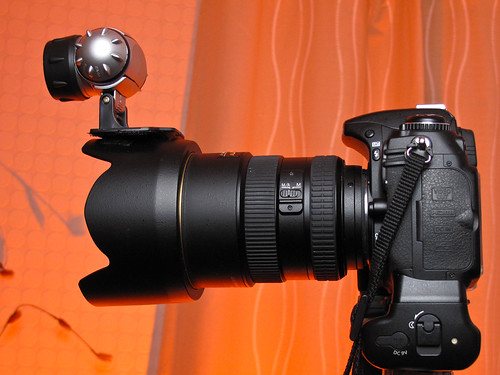

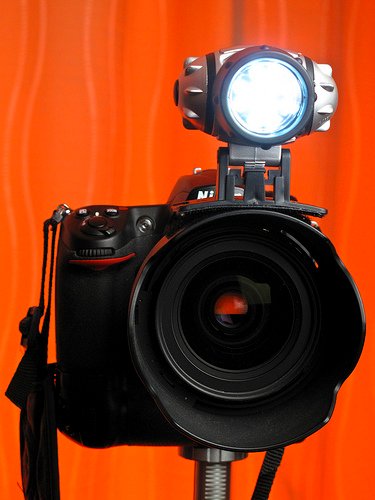

You could always try...
As much as I am impressed by the ridiculously out-of-my-league kit, I don't think it would go down well trying to get that past the bouncers.
Is that a torch on the top??
Yes :nuts:
Works a treat and doesn't have an effect on the final exposure :thumbs:
Apart from casting a huge sausage shaped shadow from the flash right across the subject's face, no effect at all ;)
Can't it just be mounted underneath - then you'll only get the hood shadow - no sausage, just a doughnut:lol:
You mean like a regular torch with an rubber band? Seen that done, and quite discreet. I have a tiny LED torch on my key ring which would probably be sufficient at close range.
The focus assist light from a flash gun projects a pattern so that it can even focus on a plain wall. Not sure that makes any difference with a normal subject such as a face though.
ummm....no, why would it do that? All it is is a low-powered light to assist focus. It's not a flash, Hoppy ;)
Oh, wait...I see...you think I'd put a flashgun on the hotshoe and then mount a torch in front of it? :cuckoo::lol:
To use it with a hotshoe mounted flash all you'd do is move it round to the side or underneath the lens hood. ;)
Probably easier to just strap the "miner's lamp" to your head :D
