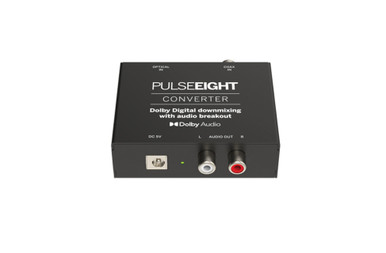

If you scroll down that linked article, you can see that it has "Digital optical Audio Out" port which would allow you to buy a DAC to convert the digital audio to an analogue signal your amp would understand with RCA cables...
I'm not sure connecting USB-RCA would work as I suspect the TV would see the USB as an input rather than an output. I could easily be wrong though...
Whats the others have suggested should work. If not one of the HMDI sockets on your TV should be marked as HMDI(ARC) which will allow you to control sound devices from the TV
One of these is the higher end version of the Amazon box linked previously:
The downmixing really helps bring out the centre channel for dialogue which can otherwise get lost in the more simple conversions from a surround sound source (the Amazon box will only convert 2.1 sources).

@anwa - I hear what you`re saying re-the Downmixing for dialogue etc , it makes sense really .. however I opted for the cheaper ""PROZOR"" product suggested by Bob although if I get this up and running and it sounds good I may just throw the towel in and eventually buy the "Pulse Eight Dolby DAC" ..
