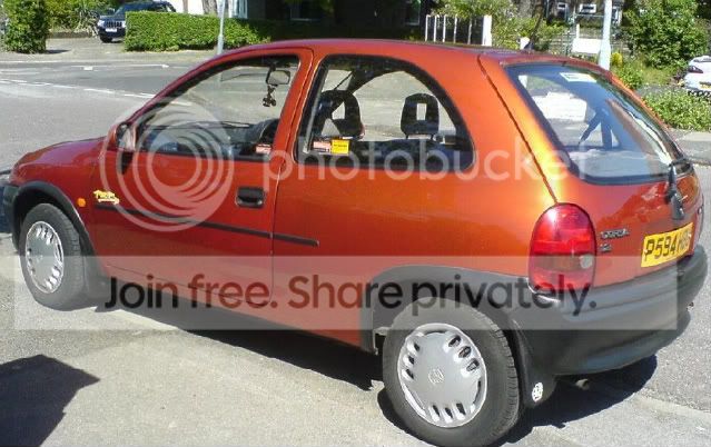

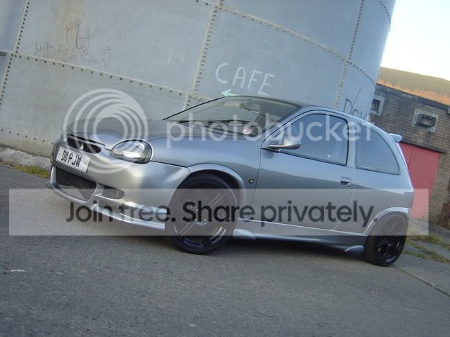

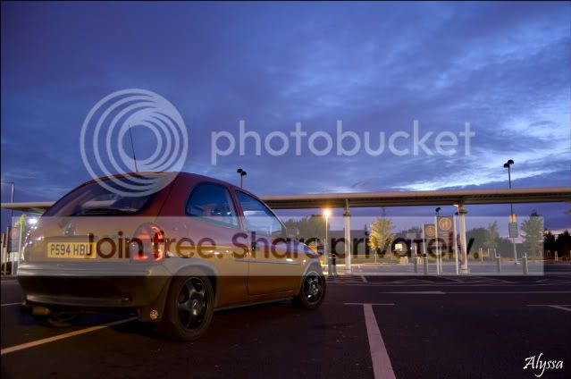

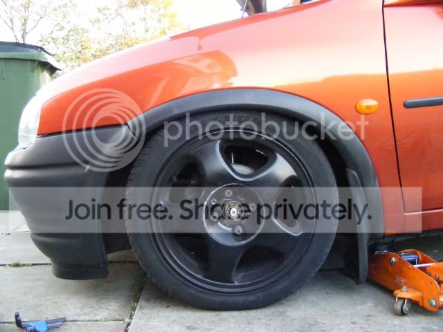

i have 'done my car up' lol
ive got a corsa B , Coilovers lowered to about 60mm maybe a bit lower, alloys, decat + exhaust got the face-lift bumpers to go on (in the process of sanding them and spraying black)
and extra stuff - added a glove box, added central locking,
Original
Uber Low ( i dont have it this low was only left this low to take picture)
Naff photo but only one when lowered and with wheels
edited to add
i am not a chav i only like subtle modifications.
i hate people with lexarse lights (unless on a lexus) snow plough body kits and paint jobs that are OTT

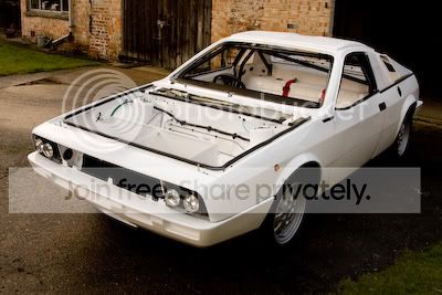

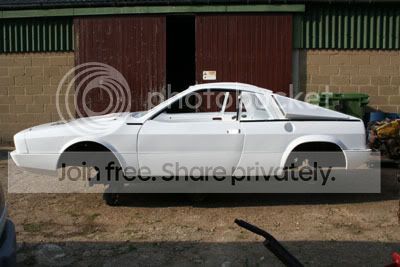

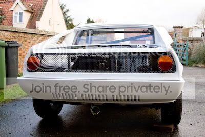

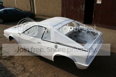

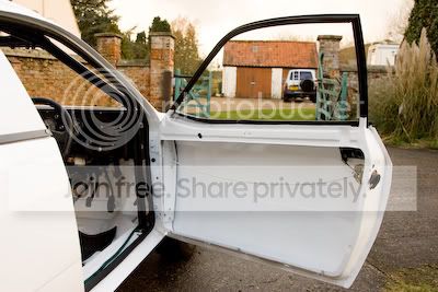

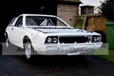

This is my project car.
1977 Lancia Montecarlo.
Stripped to bare bones - rebuilt with ultra light fibreglass & aluminium panels. I estimate its been lightened by about 150kgs (even after the 30kg roll cage has been fitted)
Engine, brakes and suspension have been highly modified - but rather than just bolting on big things - I've done all the maths to make sure its gonna work - overbored, high compression pistons, big valves, lightened flywheel, lightened and balanced rods...
I've even ripped out the entire dashboard and made myself a new one from scratch.
No hifi !
Will be used for track use.
Next job is to make myself a new inlet manifold because the ones I can buy won't give me what I want. Then I have to design and make new alternator mountings because the twin carbs will be in the way... Every mod has a consequence with other components - example - I didn't like the standard oil filter mounting as it was cast iron and weighed 5kgs because some cars had air conditioning and the same bracket held the a/c compressor, so I'm having to redesign the whole oil filtration system with a remote filter and a special oil take off pipe.
Headlamps are also used on Pagani Zonda.
Final mod will be full Martini race livery. Then it can be used on track and road whilst I start speccing up the 2nd engine for it - 16v head, supercharged & fuel injected.
