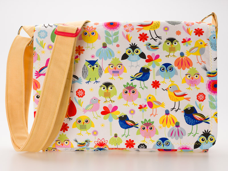

I use my G5 in the studio for product photography (with RF-602)
Here is an example (25mm Panasonic Summilux, f8, ISO 160, 1/100th):
PS. You need to make sure the camera you're looking at has a hotshoe flash....
