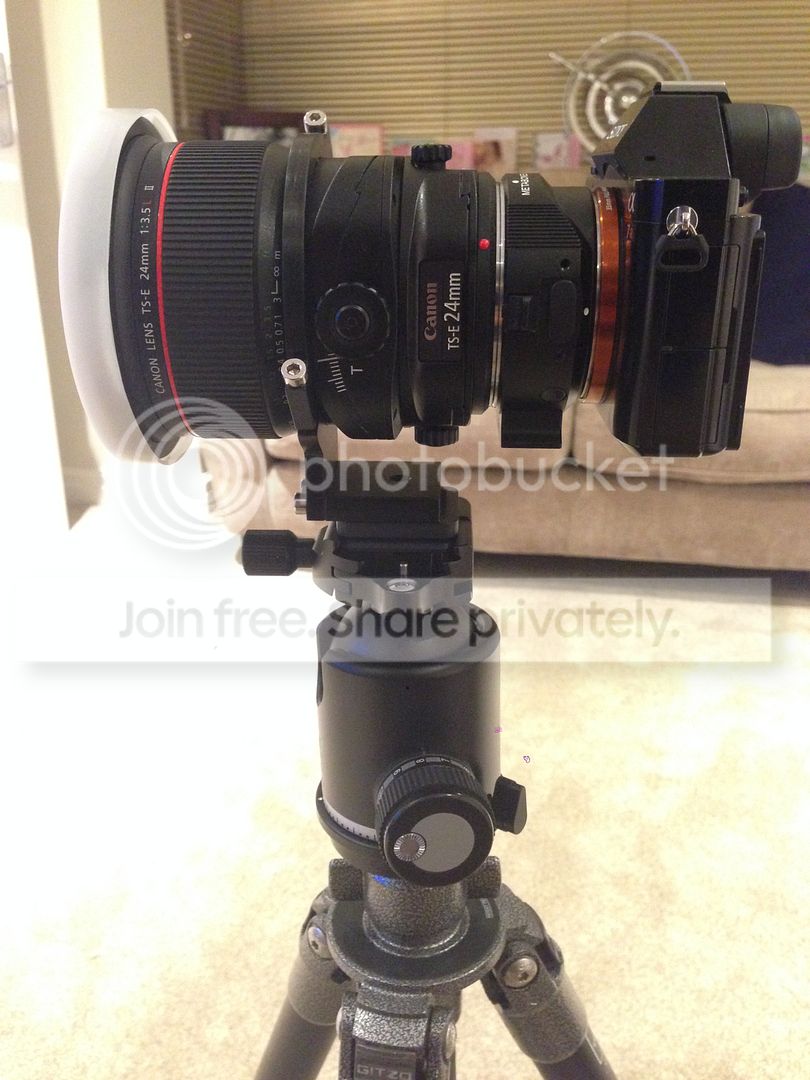

Recently got a tilt shift so I can shift the lens to create pano's.
the setup I have is a collar that grips the lens, which then mounts the tripod so the camera slides left and right and the lens stays still (the avoid parallax issues)

Do you have a photo of your set up Ross.
Here you go:

You don't need one, I've done panos with a pano head but if you slide the camera instead of the lens left and right you have no parallax issues.
From your initial post I though it was a "home made" TS lens, clearly not.
Using a TS for a pano won't give you a very wide image though if all you are moving is the camera but leaving the lens static, maybe the equivalent of 2 full frames, if that, stitched together.
I can't see any benefit to this setup as opposed to a pano head whereby you could do anything up to a full 360 degree shot.
I also fail to see how parallax comes into it but that may just be me being thick and not fully understanding your problem.
No no, not homemade. Gives an aspect ratio that I prefer, around 2.5:1
With this set up it acts like a MF sliding back, zero distortion not to mention weight saving
Anyway this wasn't about the shift capabilities, I'm more than happy with that, was more to do with the relation of the "wedge of focus" if the sensor was to be tilted instead of the lens
