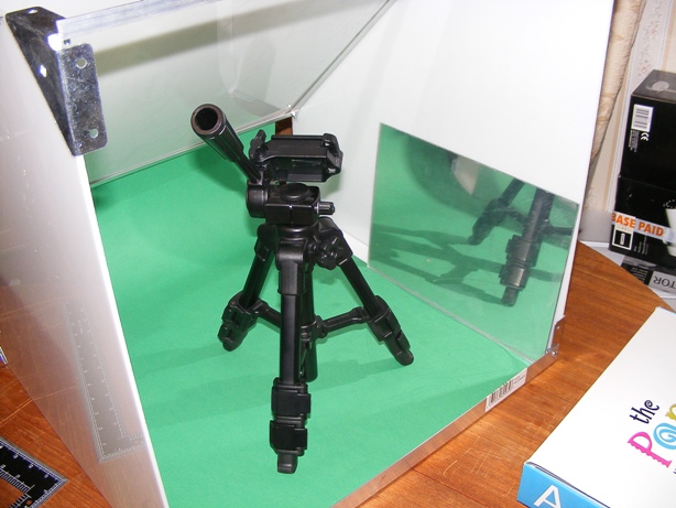

Would appreciate some comments on my homemade lightbox.
The frame is aluminium angle from homebase, the sides and angled back are opal perspex. The base is white perspex as is the lid (only there to stop the lights blinding you)
The bulb holders came from ebay and have a standard light fitting for the stands or manfrotto light clamps. The bulbs are daylight balanced 85W fluorescents, also from ebay. I also have a third light I can use at the side or front. Also a couple of pieces of A4 sized mirror perspex for bouncing in highlights.
the base/backgrounds are just coloured paper.

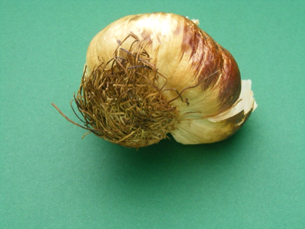

and here's a pic using it. No adjustments have been made apart from cropping.
so... Thoughts?
It looks great :)
No harsh shadows and if it's had no white balance adjustments, it's worked a treat.

Well here we go then, bit more detail on the light box.
the angled back is held in place by aluminium angle stuck to the sides with double sided tape.

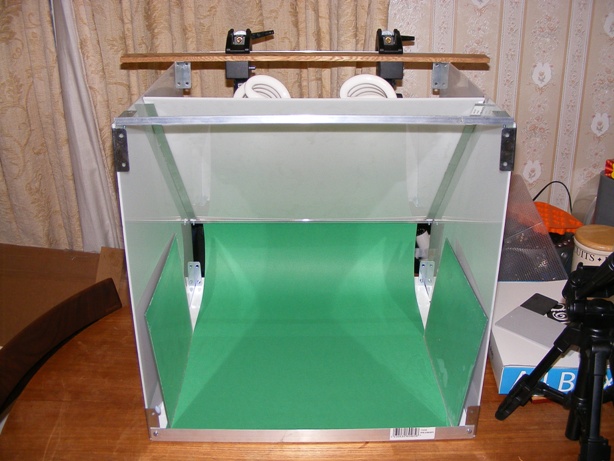

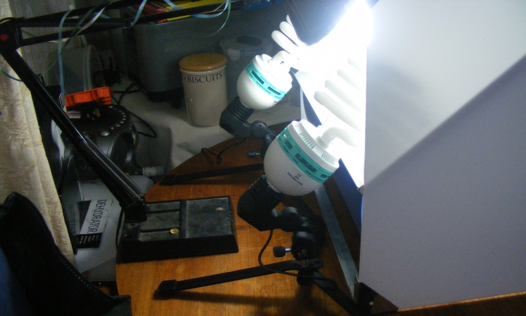

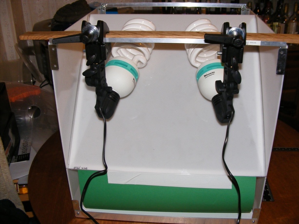

Here's a shot of the back showing the lightholders mounted on superclamps
I also have mini stands for them.

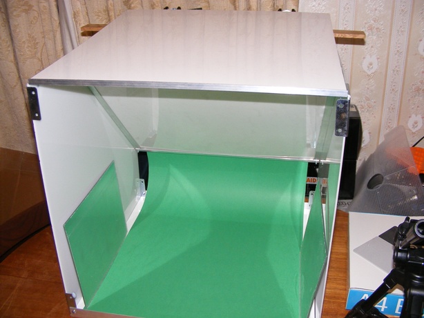

and from the front

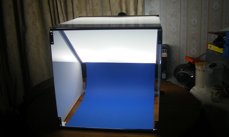

and with the top on to shield your eyes

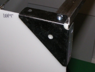

a shot of the corner detail showing how its all held togetether
as you can see the corner bracket is stuck to the perspex sheet with double sided tape and then bolted to the cross pieces.

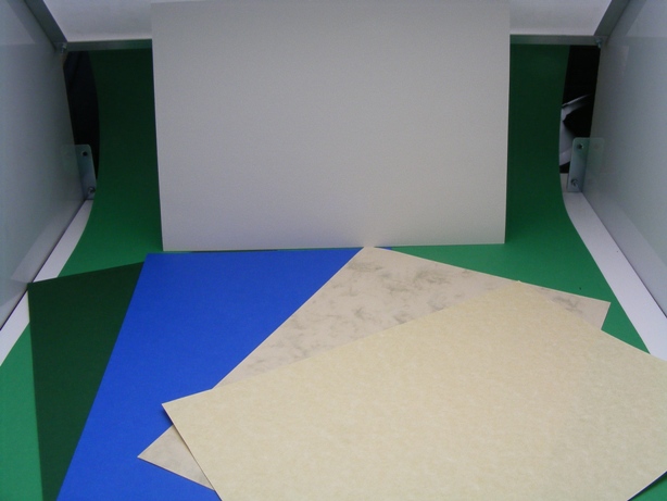

and some of the card i use as backgrounds

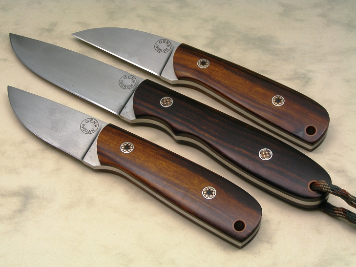

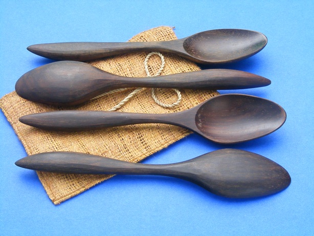

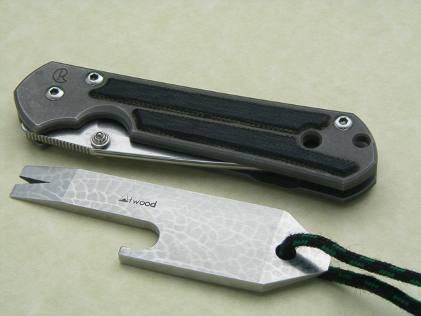

SO here's a few shots taken using the box. Only thing I have done is set a custom WB and resized them.
Nice light box fantastic results., and nice cutlery too, Chris reeves and Gene Ingram, nice;) must ask what else have you got?

Is the perspex any particular sort / thickness? I know from a project I did years ago that there are lots of different sorts of perspex that let varying amounts of light through. I wondered if the thickness makes any difference? If it is too thin maybe you would see the lights as hot-spots?

the perspex is 3mm opal NOT white. white seems to be too opaque I have used 5mm opal as well but again it blocks slightly too much. Clear works well for some applications but you do get hot spots. A layer of tissue paper can act as a nice diffuser tho. 3mm works well without hotspots as long as the lights are an inch or so away.
