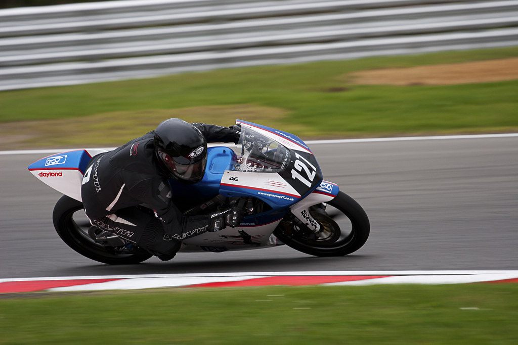

British Superbikes taken at 1/320th, you can see the movement in the wheels, probabley could of lowered it more but i wanted some keepers from my first attempt at the big boys
Fullres by BtccPics1992, on Flickr

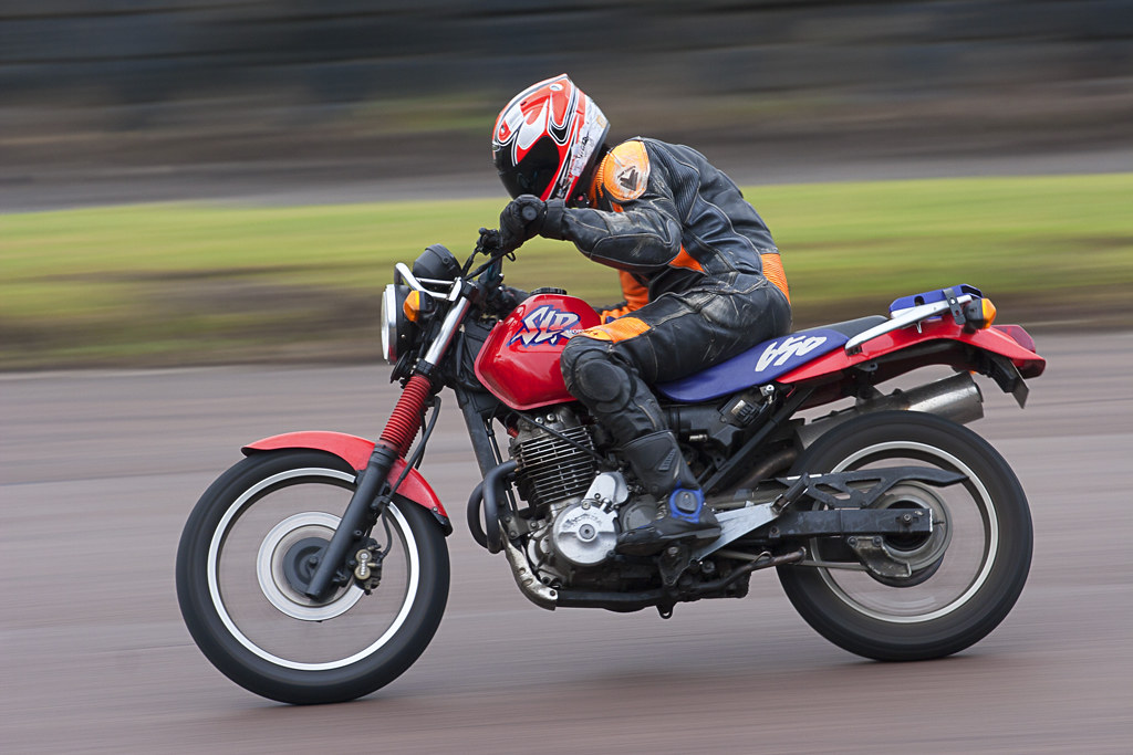

Track day, taken at 1/60th, harder to get but can you see the difference in the background in how much its blurred.
IMG_0623 by BtccPics1992, on Flickr
