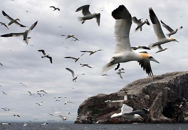

Fantastic Photograph in Thursday's Guardian. Centre pages double spread. My question is. How did he get such a wide depth of field from a nearby bird to the cliffs and lighthouse in the far distance looking crystal clear?
May 21 2008, Bass Rock, Scotland: Gannets join gulls in the Firth of Forth swooping past Bass Rock, site of the world's biggest single-island gannet colony. The Scottish Seabird Centre runs boat trips around the isle
Photograph: David Cheskin/PA

i can only think that the birds in the foreground arnt "near" at all, and it was done zoomed in a long way
could be hyperfocal distancing
Those Gannets are big birds, so I suspect that closest bird is further away than you might think. It also looks like a fairly wide angle lens, and they have huge inherent DOF anyway.
Beat me to it CT!
I have some similar 'massive' DoF from the Farne Islands of Terns, etc. all shot on my 12-24mm at f11 - DoF is from about a foot away to the horizon

Geoff, wideangle lenses generally give you a much great DOF than a zoom so the image looks sharper.

A bit of photoshop action to help it on it's way maybe?
A 10mm ultra-wide angle (or 16mm on a FF) set to around f/11 will give this, along with a bit of sharpening.
I agree. ir looks like its been sharpened quite a bit but that could be down to resizing it. Great DOF though
17mm / f16 foucused at 10m
Near limit of acceptable sharpness= 60cm
far limit of acceptable sharpness = infinity
Total Depth of Field = Infinite
and Bass rock isn't quite that far away ;)
i wonder if David Cheskin from the Guardian is gonna log onto TP and put us out of our misery... my guess would be a 16-35mm lens wide open at f16...
