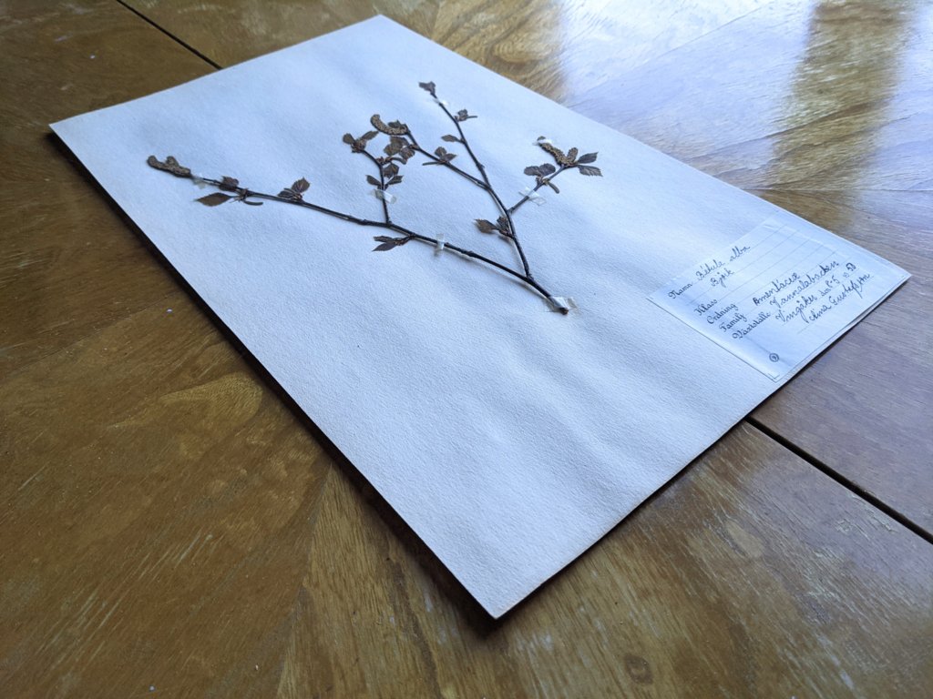

In the 50's when my mother were in her teens she collected a herbarium, and I'm now thinking about archiving / documenting it.
I'm thinking I'll place each sheet on a matte white background board, then rig a light tent over it. Either use two speedlights, or continuous LED light (ie something like the Godox LSD80). Then rig the camera to shoot down, making sure it is perfectly aligned with the background. My theory is that if I get the setup static and consistent, post-processing will be easy.
I'm hoping the fact that the sheets aren't perfectly flat will add to the images and not be distracting, but that would depend on the lighting I guess.
What do you think about the process and lighting? Any advice on equipment, like light tents or camera tripod / stand? I'm a happy amateur and have never done anything like this, so any advice would be appreciated.

Thanks @Garry Edwards! I was thinking that if I do it shooting downwards it'd be easier to swap out the sheets and get them reasonably aligned. And yes, I was thinking of fairly neutral, "clinical", shot first time around.
Just for my understanding, I shouldn't use a light tent because... it would flatten the textures and make the image too one-dimensional?
(I have done some studio portraiture, so if a softbox / umbrella and reflector is the way to go, that's be perfect).
Yes, it would destroy the side-lighting that you need to have. Light tents are for people who see them as a solution for lighting challenges, but in fact they are just products that are sold (or mis-sold) as a solution for lighting challenges, and they're useless.
A softbox would be usable from a long way away, but isn't necessary for this. An umbrella would bounce a lot of light around and make it quite difficult to obtain the high-contrast lighting that you need, the best bet would be a standard reflector, if you have one.
@Graham W Yes, they're pressed. I don't have access to a scanner (but can get hold of, for example, a strobe and modifiers pretty easily), and also I'd worry they'd become too one-dimensional. I'm hoping that with the right amount of texture and dimensional I can print some of them and frame.
