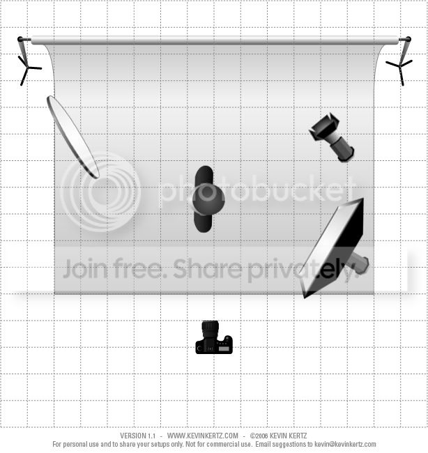

Try this set up.
The strobe to the top right is one of the d-lites with a softbox on but without the front translucent cover to try and act like a strobe with a reflector or barn door effect so as to fill the backdrop with light.
The reflector on the left will add light to the backdrop where the light falls away, because you only have one light.
The key/main light with softbox is on the lower right, just above head height pointing to the models left shoulder.
Firstly I would experiment with the background lights so that you can achieve the white finish you want.
Then add the model and try different settings so as to get the shadow correct.
If there is going to be only the two you present, tie the material in a knot at the out of frame side and then, attach some string to the knot and loosely tie it to the light stand, then the material should stay in the air. Be careful to try and not make the model move around too much as you don't want the light falling over.
It may take 30 mins after you have got the background right but I think it's a cracking idea and would love to see the shots after if the missus agrees.
