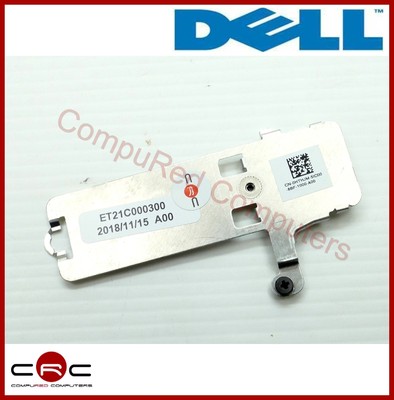

Looks like it could be an NVME SSD under the metal guard in the bottom left of the photo which has the sticker on it starting ET21C...
Remove the two screws to gain access. There may be another screw underneath at the end of the drive holding it in place, but that should come out easily and it will pop-up allowing you to remove it by pulling to the left.
Yep, that part number is a caddy for an M.2 NVME SSD
Yes, that will work just fine. I have a similar one I used when I swapped to a larger drive. I resisted the temptation to return it after use as I know I’ll need it again in a few years time when I get a new laptop.
I would double check the drive you have because from the picture it looks like it has two 'holes' in it rather than one which means it's an M2 SATA drive not an NVME drive and that enclosure you've linked to says it doesn't work with sata drives.

Good observation. Yes, B and M keys together mean it's SATA rather than NVMe.
