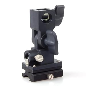

Was thinking about buying the following with left over money that I got for Christmas
2 x Youngnuo 460 flashes (non TTL)
Set of 4 Youngnuo 603 Flash Triggers
2 x Umbrellas
3 x Hot Shoe Brackets
3 x Konig Tripods
5 in 1 reflector
and a white balance grey card
I think this will allow me to dabble in several types of flash work.
Not to bad for £160. Any thing I have missed or anything you would change??
Possibly swap one of the umbrellas for a soft box? Otherwise thats a pretty good starter kit for the money.
You have the 4 Youngnuo 603 Flash Receivers, (in the picture) but is there more than one trigger, as 2 may be useful?
Sorry, just seen that the 603 is a tranceiver, so ignor this and have a great time with you new kit
If you can stretch to the Yongnuo 560 rather than the 460 speedlights, I think you may find them a better buy.
More power and can also take an external power pack. Already have very quick recycle times without the additional power packs.
