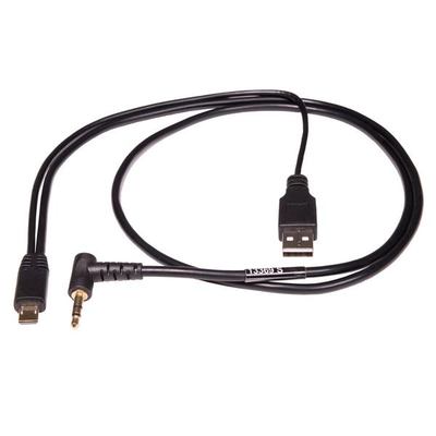

I'm using Yongnuo RF605s which have been reliable with a good range. I've wired the trigger camera as described for the Pocket Wizard and in electronic shutter mode with the Canon R, it's not sending a signal. I'll have a look at switching to PW.

PS my problem could be the cable for the trigger camera - I don't have a sync cable with a 2.5mm end so attaching an adapter might be the issue. I'll try getting the proper cable.

With the Sony's and electronic shutter you need a cable in both cameras and it won't shoot from the hot shoe as you can't use flash with electronic shutter. The cable gets a signal from the multiport and sends it to the PW. Works with Plus 3s and cheap cables from ebay but I ended up just getting a foot trigger. With the foot trigger you only need a modern pocketwizard for the camera and can use an old one for the foot trigger. Wish I had worked that out as I have about 8 old Calumet triggers that work on the same frequencies as PWs and can be used with them.
You need a special cable with the Sonys for half press. Not sure for other brands
