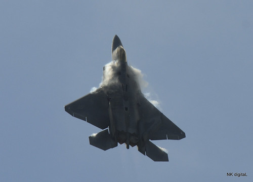

Went to RIAT on saturday and i must say i struggled with getting good sharp images. My equipment for airshows is my D300 with a sigma 100-300 f4 and and 1.7 t/c. I got some decent shots but most are too soft and i am wondering if it is because of the set up or just poor photography from me
Great capture just soft

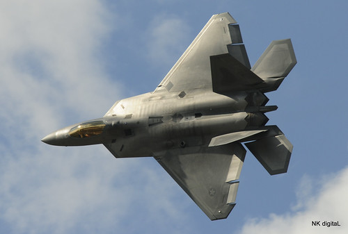

Although i was happy with a few like this one

I don't see much wrong with them,... ? :thinking: Perhaps the first one is cropped heavily? The second has good sharpness. Hard to really tell on such small samples though.
I made an error its actually a 1.4x teleconvertor all hsm motor driven so focus is fast, max aperture is f5.6 with this set up but aperture should have nothing to do with shutterspeed right? I am talking about sharpness here of glass for fast jets i want a shutterspeed between 1000-2000 of a second ideal ideal f8-f11 aperture would anyone agree or disagree on this for fast jets. Can anyone recommend an alternative lens?
first one is a 100% crop and looks soft as sh!t up close im gutted cos that could of been a fantastic image guess i need longer reach don't i?

The difference between your two shots... the first you are shooting at shadow, with a f5.6 maximum aperture your focus accuracy is going to be poor.
See how the second one is better... because it actually could see enough to focus on it.
