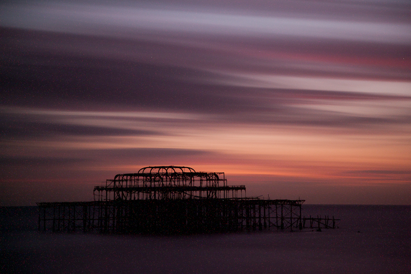

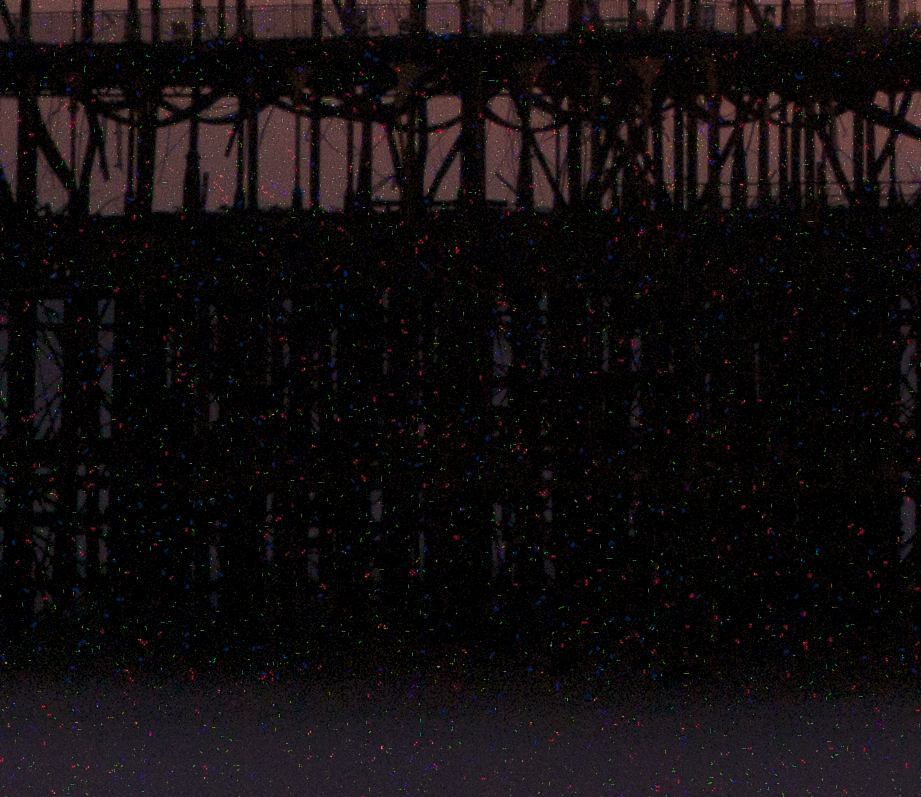

I was out taking pix of the starling murmurations at Brighton pier, and spent the best part of an hour taking stills and lot of video on the 5Dmk2. After the (absolutely amazing) display, I took a 429sec long exposure which shows some very bad noise/artifacts - see the unprocessed 100% crop below, and the complete shot to show how they are all over the image.
Do you what happened? It was taken with a 10stop ND, at 800iso, f4, and the long exposure noise reduction wasn't enabled.
My 5D has been behaving completely fine, and I've never seen this on it's long exposures before. It's not the usual noise , as you can see that 'normal' noise in shadow of the pier hitting the water in the crop above.
I've tested for hot pixels with a 120sec exposure at iso50 with the lens cap on. The image is completely fine, and a 429sec exposure I have some hot pixels bit Lightroom ACR copes with them fine so not worried about hot pixels as such.
Any thoughts why this happened? Do you think it was just because I was filming/or using Live view for the best part of an hour and the sensor was quite hot (though is was bloody cold on the seafront!)
