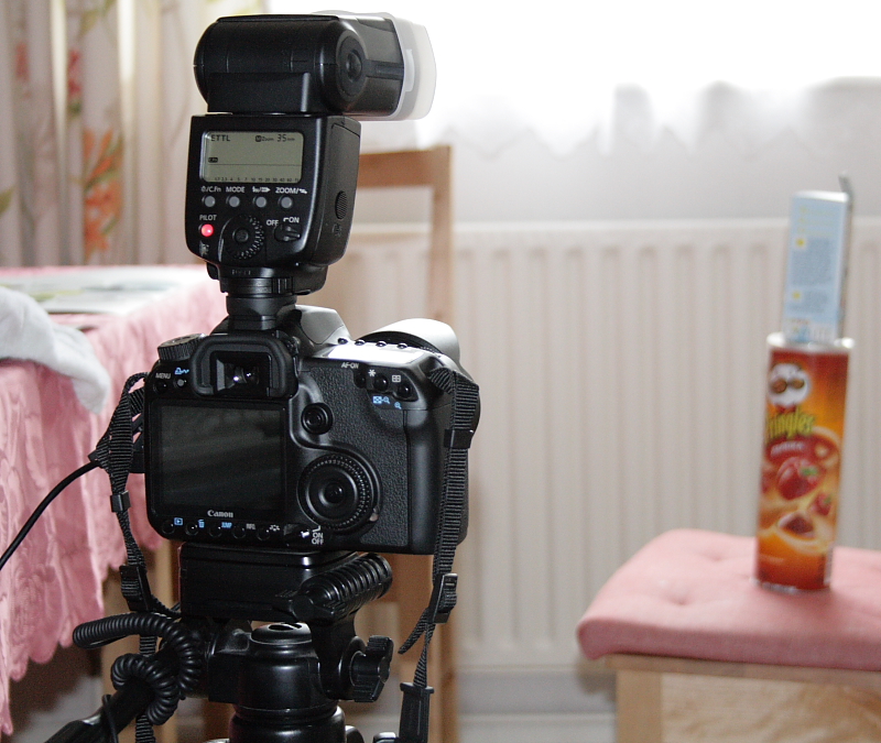

Here's my set up:
Anyone have an idea of what could be the problem? Or anyone know of a better test?

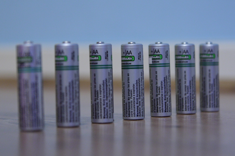

Here are more tests with 3 lenses. I disabled the flash from firing so its only the AF Assist beam works on the 580EX.
Subject is 5ft. away. Center crop (not sure if 100% as DPP doen't have that feature for cropping)
Tamron 17-50:
18-55 kit lens:
Ef 50:
Looks like Tamron lens is going back to amazon!

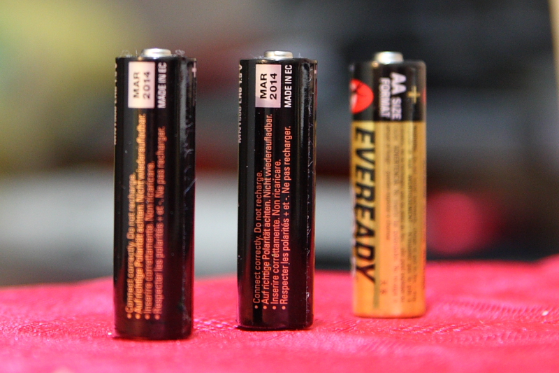

Sent my Tamron 17-50 for calibration. After 3 weeks, it came back spot on.
Sample test pics:
