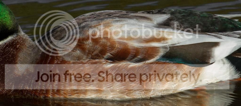

I'm not sure it'd manage this though, from my 70-200 f4, this is wide open at 200mm
100% crop or thereabouts;
