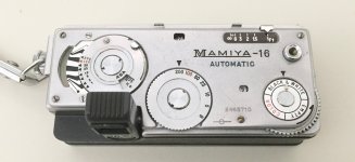

The camera, a Mamiya 16 Automatic.
It's an Automatic, Jim, but not as we know it! Automatic here simply means that the lightmeter dial that you turn to match the selected shutter speed with the light meter needle is mechanically linked to the aperture blades, so that as you match the shutter speed to the light meter needle, the aperture is 'automatically' adjusted.
Per Wikipedia, it was launched in August 1959.
Lens is a 25mm Mamiya-Sekor f2.8, stopping down to f16. Closest focus is 1 foot. Per the instruction manual, wide open at closest focus the depth of field is +/- 1/4 inch.
Image size on film is 10mm x 14mm. There is a PC socket on camera base plate with accessory shoe on the side for flash. Size is 104×32×48mm and weight 270g.

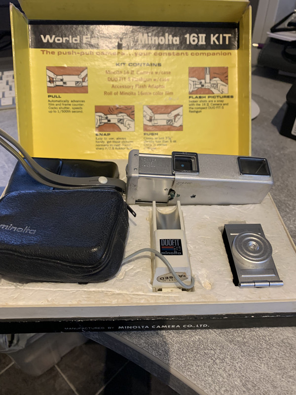

Here’s my 16mm Minolta- not used for a long time. I’ll see if I can scan some prints. Not sure if film is still available but I might sell it anyway as it’s a waste just stuck in a cupboard
It would be great if you could scan some photos, I'd like to see them.
As to film, other than for 110 cameras where Lomography still sell it, for both the Minolta and Mamiya 16mm cameras it's a matter of either using 16mm cine film, or using a film splitter to cut down 35mm film, and then loading into the cassettes. Finding cassettes has always been an issue (amplified by the fact that Minolta and Mamiya used different cassettes) but 3D printed ones are now available off Ebay.
